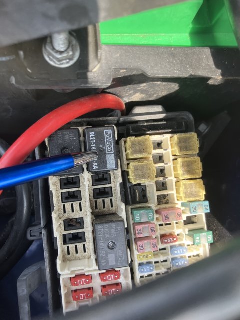

You might want to verify that your cooling fans are still functional by locating the relays and checking that they are not fried.

There are several identical relays that serve different functions. I usually pick a circuit to temporarily borrow a relay from to verify that the relay is the culprit for the failure. If the cooling fan becomes functional,you found the problem. image.jpg
