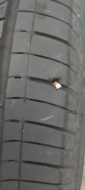

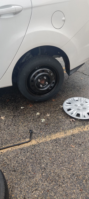

Hope your weekend goes better than mine has started off so far! Looking close at the tires, they probably needed to be replaced anyway. I assume those are the ones that came on the car originally.
1,877
1,591
I can’t see the wear bars, but yes. It’s looking like the time to get a fresh set.
With this being said. Any tire recommendations? I see they have "Highway" tires now, I don't recall ever seeing those type before.
1,877
1,591
You don’t want a “non” snow rated tire. You live west of Lake Michigan! That means you will have Canadian cold air and everything that brings with it.
if you are still on the original size tires you would benefit from going to a 195 over the 185-15 size. Those seem to work out better on rough, pot hole riddled roads.
can’t recommend any particular brand. But you should be placing a lot of emphasis on wet traction ratings.
Or, if you are planning on keeping the Fiesta for at least three more years, get yourself a set of Michelin X Ice, Bridgestone Blizzaks or General Alti- max arctic. They are snow and ice rated tires. Once you have experienced a set of those, it will change your mind about the value of seasonal tires!
Plus, you then have a good excuse to get a nice set of alloy wheels and performance tires for summer use.
