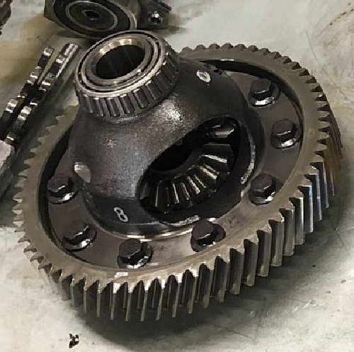

This is a view of the opposite side showing spyder gears in the housing

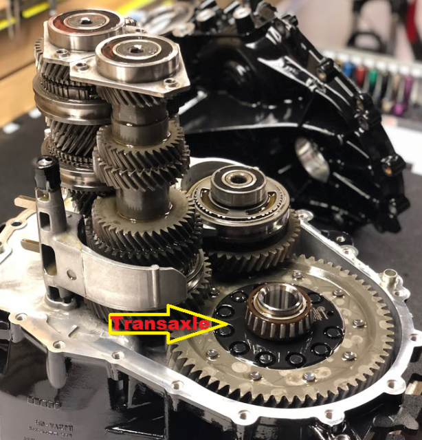

Because of the transaxle and transmission are integrated but can be separated, the issue of a bad transaxle bearing plays IMHO more of a role in this.
