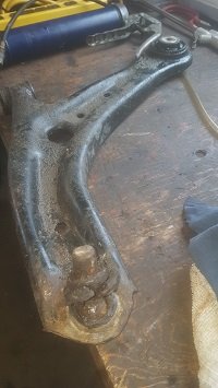

I have this available from my local NAPA. It is the premium unit. I will have to verify that it does actually have a greaseable joint or if its a miss-representing file photo.
NAPA fr control arm (left)

LCA is the only way I have been able to source a greaseable BJ at this point. I can justify the LCA as new bushings would be valuable at 200oookm/125ooomi considering the roads I have to deal with round here. I see it as valuable long term and I want this car to last at least 5 more years.
Verified, and in my garage awaiting install. The NAPA premium control arm NCT 2607474 (L) and NCT 2607475 (R) has a zerk.
