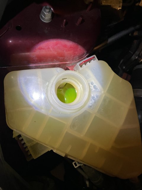

Ok, let me try to share a picture. I don’t have a bottle of the VC13DLG so don’t have a benchmark to compare. I do plan to buy a bottle and fill it so the level goes above minimum.
Is this “green”?

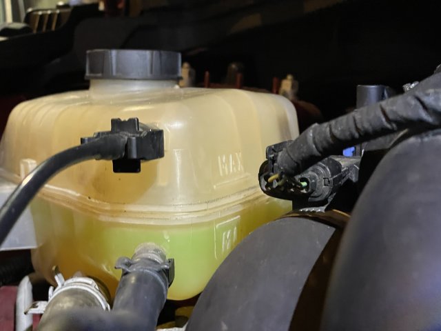

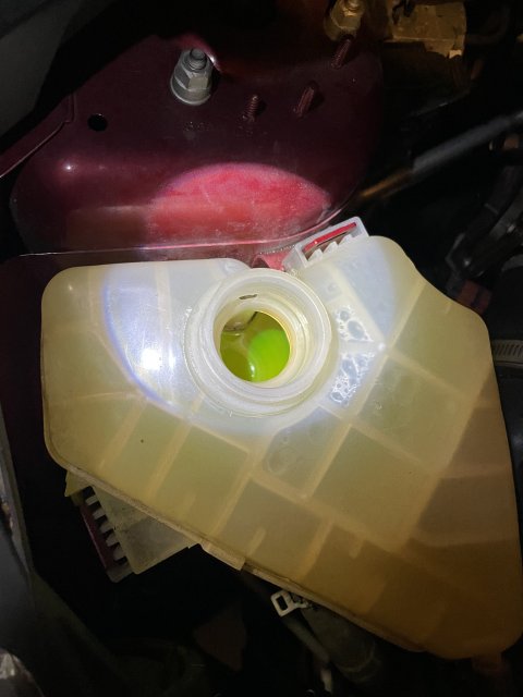

Also, thank you all for replying. I have been so nervous about this since the car broke down. Who expects to put in a new engine on a car that’s only 9 years old? Besides, I take care of the car. I’m not knowledgeable about it but I do take the car in for regular service and always to the same Ford dealership and they do all the maintenance.
Update: I took two more pictures after the cap was open this morning.

Its hard to tell from the pictures. Green coolant is almost glowing, fluorescent looking. Like its electrically powered, lol.
Yellow coolant is just that...yellow, like lemon jello. The VC13DLG is listed as a yellow coolant by Motorcraft.
i would not mix the orange coolant with the green. Mixing any colour coolant can have various consequences from mixing additive packages, which could lead to unwanted pH levels. Basically choose one and stick with it.
+1 - again! @SyntheticAtmosphere
...Having to have lost a Heater core to the Red (Toyota) when someone added "green" to top off the Scion - you can lose a motor by some simple mistakes and using less than a cup can wreck your day and even your motor.
So the Yellow - which you have, is considered "Global" and universal - they took the easy out and used a fluid that has less but is better build or formulated for more of a universal fit using the vehicles older or own coolant additives to simply replace the level of liquid lost so the cylinder head can keep cool.
