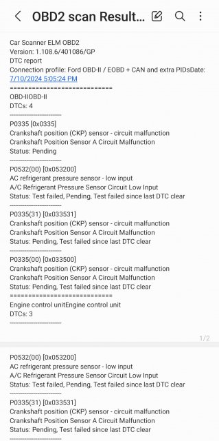

These are the OBD II scan results.

There you go. Check the crank position sensor.
