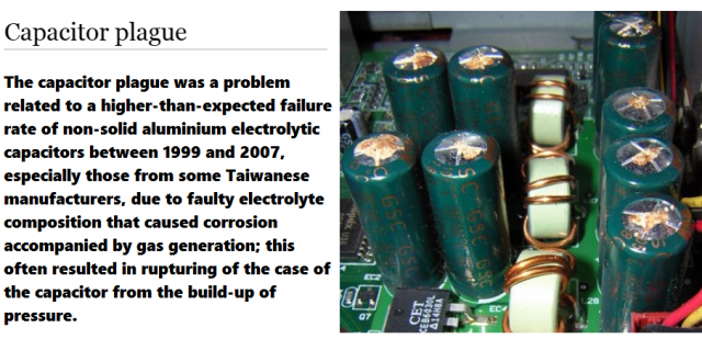

When you have an older car, many Gremlins that show up are due to the failed defenses of wiring, components and or a combination of both...Broken wires, onto poor contact or corroded convectors onto bad components caused by power spikes in the electrical system - can cause conditions like this.
The problem was "solved" by adding other elements to reduce the drying out condition
as well as breakdowns - Galvanic and Electrolytic actions that destroyed their plates.
An article based upon the above definition including it's own history
- here at Wikipedia.
  • The condition may have occurred in your own vehicle. Due to development and reserve of parts to build the modules.
  • We, you or anyone - cannot determine that, until you tear down these electronic systems and inspect them to determine the age of these components and if they were part of this problem.
The vehicle is a 2008, so I can only presume that although taken the utmost care of, you cannot get away with the impossible being that it was designed to last forever.
Age of the electronics are show up in various ways. Including the failure of systems - they just don't work anymore - why? Failed or dried out capacitors that are designed to filter, smooth out or detect - power supply feeds and the other systems that rely on this can quit working too - can affect operation - as similar to minor quirks becoming cascaded failures.
  • That is just one cause of a condition - there are many other ones we haven't even considered.
  • Age, being both wiring and connections - Copper in it's refined form - does go thru a process of reduction so corrosion of the wiring is inevitable. The jacket composition can be of two types - a plastic or a soy-based polymer - both have a finite lifespan.
  • Connectors - their plating is not infallible to moisture water and or salts and minerals that contaminate the contact points.
  • Bolts; hold the vehicle together, used to provide ground points - hold seats down - keep the strut and springs from falling out - all will rust and weaken.
The problem also lies in the ability to find spare parts for such a limited edition vehicle - which in order to preserve the vehicle you have to tear down the systems and inspect wiring and fix the many intricacies of the wiring connection points and components used - to ensure the continued operation of their systems.
Now, whether this happened in your vehicle is hard to determine without your electricians working their "magic" in isolating or even probing to find problems what seems to be akin to intermittent connections caused by the wiring failures.
