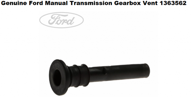

Hello got a problem with my gearbox as it’s leaking oil out of the vent pipe, replaced the vent piece all together and still no luck

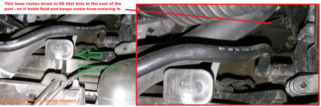

The above is a TYPCAL IB5 vent - in the Fiesta we have a
sealed hole that routes to a tube and uses the same port this seal uses.
But, the housing at the other end - clips to the front radiator upper housing
ABOVE and to the FRONT of the engine - it's a little black box that holds
the fluid when it gets hot and expands, but stays contained and a vent allows
to keep air pressure to equalize pressure so the force of the expanding fluid
won't blow out a seal.

So, you replaced the vent piece - so that is the upper vent and expansion port, but the mess is leaking out, possibly at the vents seal on the housing or the whole seal at the vent on the transmission housing - so that will have to be looked at and replaced. It is on top of - highest point of elevation from the ground on the transmission housing.
