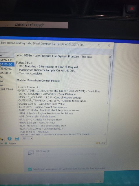

Hello guys,
I have a big problem with my car.
Today i was driving on the highway and i lost power, the engine stops.
Also on the display i have the wrench light and it says that the battery charge system is defective.
I drive it near the road and it is cranking but the car wont run.
After i plugged in forscan i had several faults as you can see in the attachments.

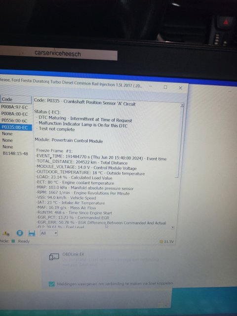

The important fault is
P0335 Crankshaft position sensor A Circuit.(if it is the sensor is then the symptom that he shuts of and wont run anymore?)
The other follow up faults are,

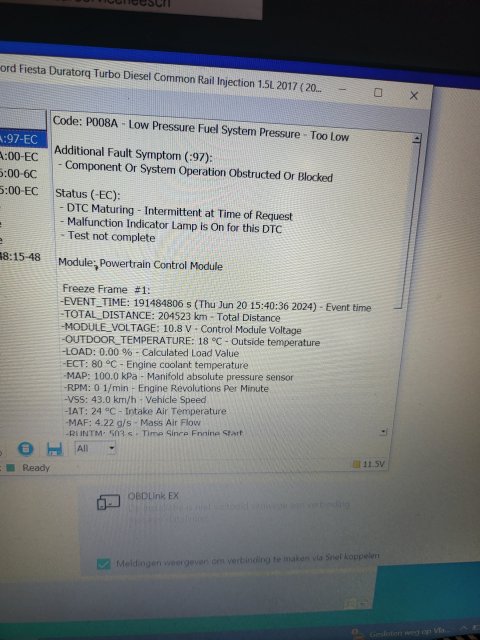

P008A Low Pressure fuel system pressure- too low Additional:97 Component or system operation obstructed or blocked

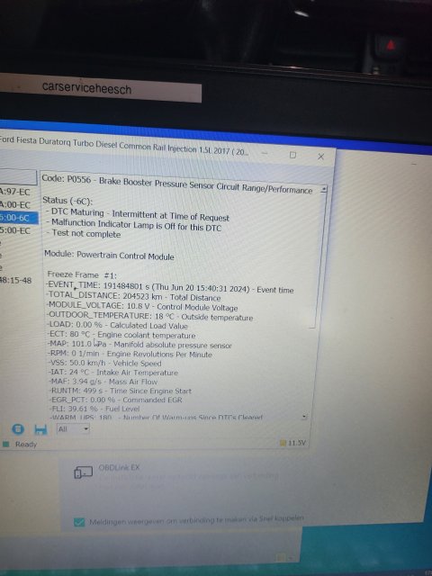

P0556 Brake booster pressure sensor circuit range/performance

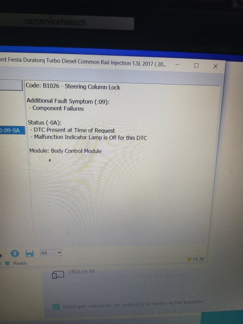

B1026 Steering column lock- Additional:09 component failures
I think that these faults are follow up because i drive the car on his own speed to a safe place without power steering.
But i am not sure because it is a car and it could be almost everything.
So does somebody recognize this problem and faults or have experience with this faults.
I tried my best to describe the problem but if anyone has questions please let me know.
Thanks for your time and maybe answers and a solution
