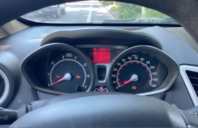

I have a 2012 Ford Fiesta SE with 82k miles. Recently in the last few weeks, the car stops randomly while driving. The accelerator will simply stop working and you won't be able to go anymore, which makes driving quite dangerous. The lights turn on as shown in the image and the check engine oil comes on in the clock screen.
