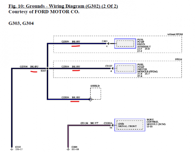

First place to start is the battery grounds. Clean the cables off at both ends, sand or wire brush the connectors, and the contact points. Intermittent grounds are turmoil for modern cars.
I actually did that the last time this happened a few weeks ago, the terminals didn't look too crusty but I hit em with sand paper anyway. I'll try doing a more thorough job tonight with a wire brush all over, thanks for the suggestion.
Next would be fuel pump ground? The pump is under the back seat. Follow the wires and do the same.
Just so i'm clear, you're saying to clean the contacts for the wires on top of the fuel pump, or somewhere else near the fuel pump? Am I following the wire from the fuel pump or to the fuel pump.
A thread started on 13 January of this year titled " Electrical problems" in this section is an excellent visual guide to what Lions tooth is addressing.
Our modern Fiestas are very sensitive to drops in the power supplied to the various electronic devices operating in the car. Those power supply drops or interruptions can be the result of either a weakend battery or, as corrosion that has formed on one or more ground connections.
Any Fiesta that is operated in a consistently damp or salt air environment should have the electrical grounds cleaned and treated with either an protective anti corrosion treatment specific to the purpose or at least a good coating of petroleum jelly on known clean and tight connections by the time their Fiesta is three years old.
Not taking preventative actions is the same thing as inviting ill tempered gremlins to ride along with you in the hope that they won't make trouble. Trouble is what they are all about.
We are slowly creating a fairly comprehensive " Fiesta Electrical grounds maintenance" guide on this forum.
This will become very important to keeping the modern Fiesta running (or, any modern car really) reliably into antiquity. Without maintenance of the electrical grounds and harnesses, all
modern era cars are doomed to electrical system rot.
I would identify the ground at the pump and clean its origin at the body.

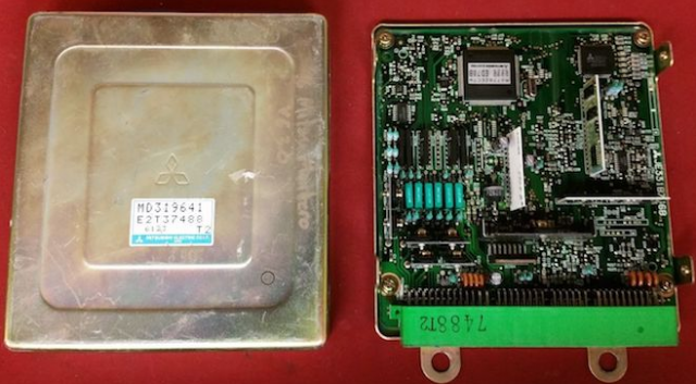

Photo of a PCM with the cover removed:
