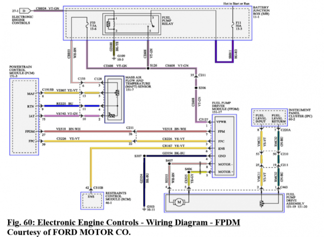

You may also own a Fiesta that uses a driver module that in the event of an accident or rollover crash, the system tells the fuel pump to shut off. Those are called FPDM Fuel Pump driver Module. Else the Fuel pump and the fuel line towards the front of the car - has a transducer to tell the system how much to regulate the pressure by running that motor thru the Fuel pump relay - you can hear a tink-tink-tink spaced about every 5 to 7 seconds, that is the system tellnig the Fuel pump to turn on and off runnig a relay to do so.
