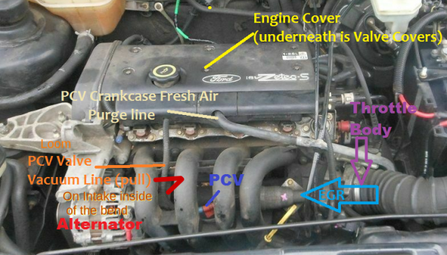

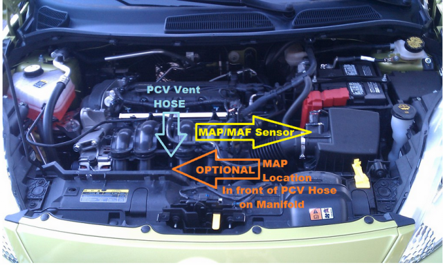

To add more to this, the engine as it warms up - needs time to settle down and stabilize. On the newer engines with less miles this was not so bad it added the right level of fuel and nary a problem with driving right away after start.
IT still thinks it can do that even after years of neglect - so to start having this problem after this many years, not too bad, just do up a method to clean the throttle body bore, check all your hoses and even the air filter for dirt - change the oil to a thinner viscosity (new oil is thinner than older dirty oil) as you get it prepped for winter - might want to clean the MAF and MAP sensor as you can - have a mechanic help you find these sensors - and clean them off with a sensor safe spray cleaner to remove older dirt and oil from the sensors reinstall and connect and see it this helps.
Not sure of what engine you may have to help you find some of these sensors.
