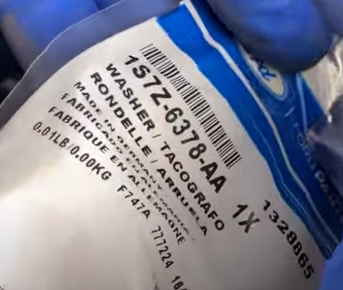

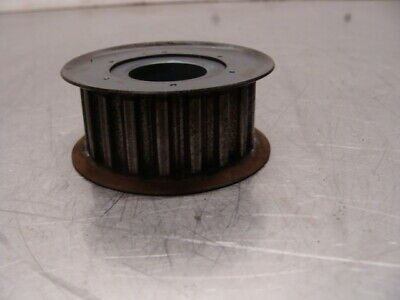

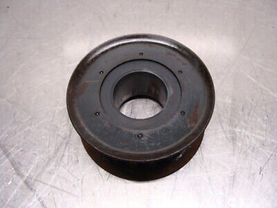

Ok. Isee all you are saying. And I looked at the pictures you put up. Answer me one question. What engine e code are you referencing? It's the 8th digit of the VIN btw.
First off, the engine was factory original. No work had been done to the car when it got to me.
Second, when i removed the crank pulley/harmon8c balancer i marked it with a green paint marker incase there was an alignment issue.
Third, there was no "zirconia washer or a washer at all behind the crank pulley when i diassembled it.
Fourth and lastly, my crank sprocket looks nothing at all like the one you posted. I think we are talking about 2 differe t engines. My sprocket has absolutely no marks on it related to timing.
so I ask again...or am I ranting? Again, What engine code are YOU talking about?

Ha ha ha .... ok, I have an update. Called the dealer. Gave them my VIN. And lo and behold..... my engine doesn't use either that washer or crank sprocket. The washer fits the...like I said...2.0 and 2.3 engines. Now, you understand this info is from the dealer. Not my opinion.
So all that tech talk about aspects and zirconia impregnated washers.... IS NOT FOR THE FIESTA 1.6!
