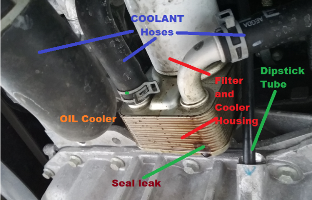

Crawl under the front of the car - look at the engine - behind the radiator - it should be an oil filter.
IF the oil filter is leaking - it may only leak when the engine runs - so oil is pumped under pressure if the filter is not tight or correct - the seal will leak but only when engine is running and maybe if it sits you might find the extra drips form under the car is it finishes the drip.
Else the engine might be leaking in a spot you can't see - like the top rear sides - like a valve cover seal is bad.
Check color of the radiator fluid in the coolant tank - if it's looking dirty and not like it used to - then oil might be leaking past a bad gasket into the coolant - requiring service.
