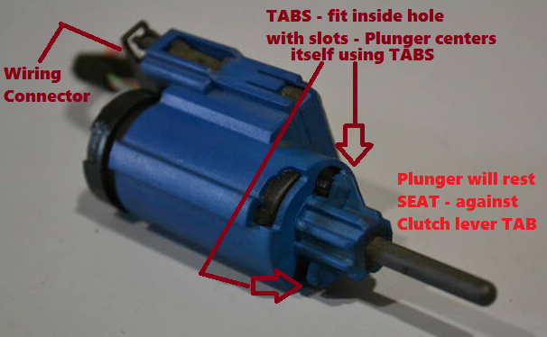

Look for this guy, may be White or Blue or even Black
in Body color...
The Clutch position switch, is located Under the Dashboard, by the Clutch pedal -
Grab a flashlight and find the lever - it will have a "tab" that works with the Clutch pedal -
Once you've found it, press the Clutch pedal to the floor -
Follow where that "tab" goes - it should go to a switch - (or a Flange) if the switch is simply dislodged, you might be able to reseat the switch back into the holster
How that works is by it uses two tabs, and a 1/4 turn - the tabs line up to the slots, where that larger tab "seats" against - the Plunger of the switch goes into the hole the tab's follow suit, the entire mess is seated and to "lock it" in place, the you turn the switch housing 1/4 turn to lock the tabs and keep the plunger in place.
This switch is so that when you press the clutch, the plunger will engage and allow the system to know you are shifting.

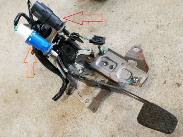

Then look under your dash, for the "Brake" and look for two plungers...
One plunger is for Brake light, the other is for Bypass and Hill Assist (as needed) These two plungers work when you hit the brake to help with releasing the "sport" mode (so it doesn't stay in Gear when you come to a stop.
The Black one is Brake, the Blue is a Bypass (Cruise) / Hill Assist designed to engage SOONER than the Black - Brake light plunger.
  • What SOONER means is how the operator pressing on the Brake pedal - one Plunger will send a signal Before the other, (OR at the Same time)
    • Are you checking your Rear Brake light operation? IF the Brake Light, as you drive, stays on, remember this can set the condition you are experiencing. IF it doesn't come on at all, as you begin to brake - this is another condition this code can show for, meaning that the brakes are dragging.
  • What can happen is , one or both of the Plunger can stick or ones throw compared to the level of engagement the Brakes Master Cylinder PISTON does, can trigger an error. The LOAD on the Engine MAF/MAP and TCM - it is supposed to look at Brake Light Plunger (Stop) as the ultimate "override" - if one plunger is not seating or sending the proper signal - as an ASPECT of operation (Depress or Release) code, excessive wear can result - so the code gets set.
IF these Plungers "aspects" are not correct, this set a similar code to yours.- again like the "3rd pedal" that you would have for Manual.
The Biggest clue I get from your posts are the reference to pressing the accelerator to get the thing to "go" in first Gear.
1st gear the powershift it needs a bit more accelerator pedal to begin to move
So since you mentioned "gear" - I figured you mean you had a manual.
In reference; you do, only the Car does that job when you "hit those buttons" which in light of your situation - make sure the "Shift - time buttons" they've been cleaned and free of French Fry Grease, Ketchup and other debris from dirty trigger fingers
A dirty switch or abused shifter (especially when used) You just don't know whom else got a hold of and did some rough handling that can cause underlying problems.
But in BOTH cases - if a Plunger is stuck (gone bad), off it's mount or has been removed, you'll get problems with shifting like this.
Hope these ideas and hints can help you diagnose the problem..

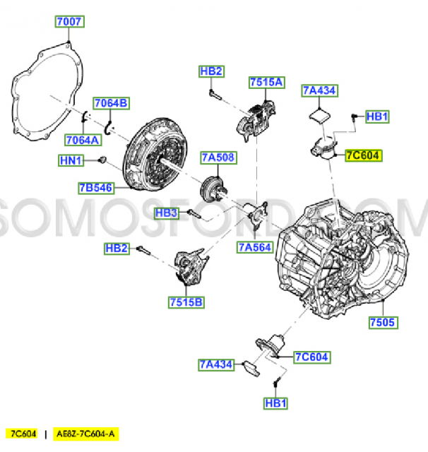

in the post above, it says that the 2 clutch motors are easy to remove and reinstall without taking out the transmission

The problem with just "swapping out" is the inability to inspect much of the transmission - you can replace the actuators, but cannot guarantee that the problems will go away.
You don't have anything to lose at the moment - so if you can get yourself back on your way doing this, then by all means try!
