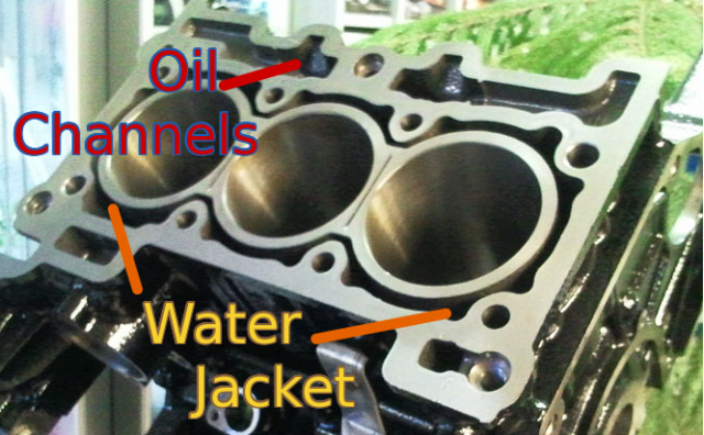

  • So with the above in mind the excessive pressure caused by that increased charge passed into each cylinder - the gaskets are the most weakest link in the process. Blow-by gasses can spill into both the coolant and the crankcase by rings - oil channels and the coolant jacket - its from that distortion of the seal for the cylinder head, is how this can happen.

As another hint, look and locate the cylinder head bolts in the motor - and note how the jacket and sleeves "float"
