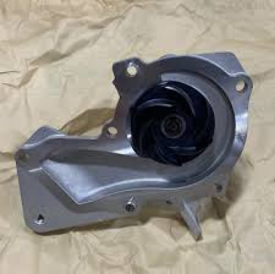

You might want to reinvestigate the water pump.
The OEM one versus the one you're replacing it with.
Why?
Porting - the OEM vanes go a set depth - and maintain a pretty tight clearance in the cavity - but if the replacement has a different shaft to the inside or the impeller is too small (Referring to rebuilt units or used pulls) - the vanes spin, but don't throw enough of the fluid into the ported chamber to get close to the thermostat so it can feel the heat. The higher RPM usually pushes the fluid far enough and with enough force to get at the thermostat and start to open it. But if the vanes are not close enough to the ports and the cavity - the force of the fluid just swirls and doesn't gain any momentum in any direction until there's a higher continuous RPM that is enough to spin the fluid and make it throw far enough to pump or move in the ports. Also - there is a bell or bubble valve on that thermostat too, it has to be on the top of the thermostat when it's seated in the throat of the outlet. Kinda' important, if it can't "breathe" then air pockets that are formed from the "boiling" just sit there - the thermostat takes a L-o-ong time to sense any heat and open up. This goes without saying but you may also want to double check the spring side of the thermostat is on the INSIDE of the motor - else too much heat is needed to open the port to circulate the fluid.
