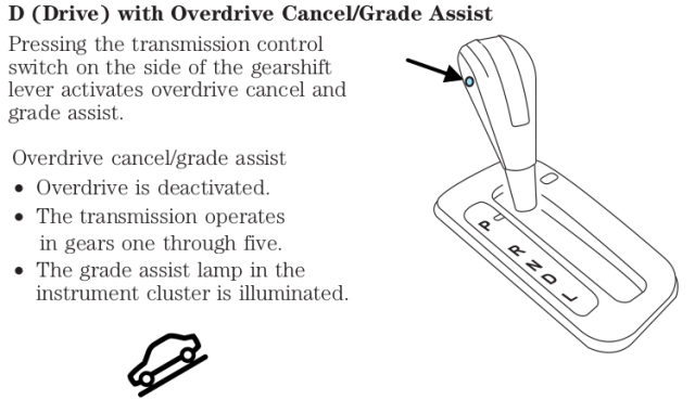

Not sure of this could apply, but the "Sport" in the DCS seems to have been a spinoff of a feature they put on the "S" or SE models as a means to Hold a gear during hills, downshifting and even accelleration - prevents the system from using Overdrive and it's "lockup" when the speeds are too low to make the lockup efficient. Which is their judgement - not mine.
Looks for this
The Car on a Hill light on the Dash lites up when that switch on the shifter is pressed.
That "holds" gears for both acceleration and deceleration.
Although mostly used for people on icy or slippery roads, does come in handy on wet pavement too in helping to slow down the car by keeping it in a gear versus the more "freewheeling" effect you get when you back off the throttle let the vehicle coast.
Give it a try - see if it does what you want the car to do.
Else the "S" and the transmission supplied with them, is somewhat limited in capability.
Looks for this
Hello!, thanks for the suggestion. Tried it and i guess its close to what i wanted. Also can you enlighten me on how the sports mode on the “S” does? I haven’t actually tested one and from what i saw from a few clips on YT it basically lets your car rev higher(?) before shifting.
The button is changed to more of a rocker switch to shift up and down the gearing when it's placed in "sports mode"
To be honest, it's just another way to screw up a good thing that they did in doing away with a lot of the lag and other transfer of power from the engine to the wheels - it can ruin a perfectly good running car because the owner forgot to shift at points or shifted at points the car was not really meant to be shifted into or out of.
As you may already know, you will also experience the transfer of power to speed in the newer transmissions by their using of a gearing ratio that is closer to a power curve and torque band of RPM the engine can develop for and become quite efficient at for emissions and the Fuel consumption - the DCT/DCS is simply a preview of this with fewer gears than that which is being sold now in latter models of other brands having more closer and matched gearing - they learned from Ford how to do it. Only they use a lot more gears.
You just have to be the trigger to shift up and down which can be quite tedious in stop and start traffic.
At least you might get tendonitis in your thumb by trying to keep up. [cheerleader][raceflag]
