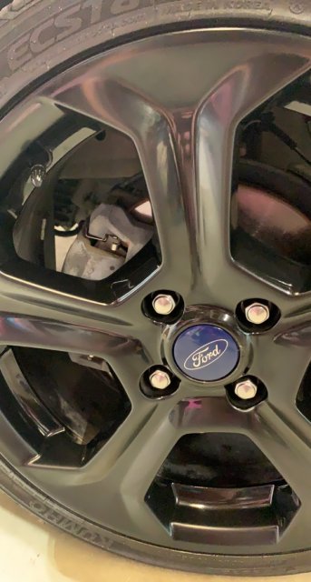

Need to paint these things. Tired of the look so time to fancy them up. What’s the best paint for it?
