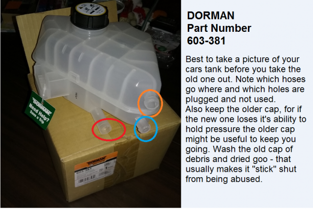

There are other things you should look over...
That cap on the bottle, one of the reasons for the "eruption". Other things to consider before this occurs, or burst, is from the weep hole and the side plugs it uses, the side plugs on the tank are for the burp tube, the main coolant bubble and level (small pockets always occur, so the larger hose help burp the radiator as well as show level) help to provide some way to remove the air pockets and gasses from the acceleration moments that pass by the oil and the gasket in the head when pressures are high.
I think you really should occasionally loosen the cap, take it off and look down in there to make sure the weep hole that is behind and in the "flange" portion of the cap - is clear - so air, fluid and steam can blow out.
It's like checking oil, if you don't you can get stranded. So the cap has a "click" moment when it properly seated - so loosen inspect retighten and turn until it "meets the detent" and this helps the valve also from keeping pressures from going too high from LACK of ability to release - it's stuck shut in goo and sugar from the glycol that freezes it in place.

Get rid of it. I have had these fail because the top split and also had one burst on the side facing the cam belt cover and the last one failed at the neck of the filler cap.
This part is a disaster waiting to happen. The good news is that they are very easy to replace and not expensive! They are, in fact, practically free compared to the cost of hiring a tow truck or a new engine.
If i sound militantly biased against trusting this part it's because i am militantly biased against trusting this part.
I have taken to using a permanent felt tip marker to tattoo the install date on the top of these reservoirs! They are a three years and done maintenance item.

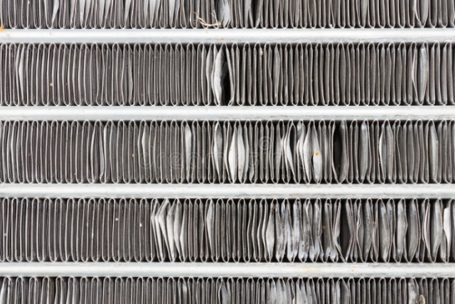

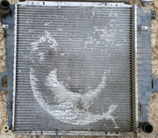

If yours comes with AC - might want to take a moment (5 minutes really) to rinse out that radiator and condenser, if it has not been done already.
Why?
Car washing only affects the surface, or skin, there's that undercarriage too, but that only does the bottom and rocker panels.
What about the front, your Grille? When air comes in, does it freely go thru both the condenser and radiator? Can you feel heat arriving to your feet when you stand outside the car and the AC and the fan is on?
It should be pulling a lot of air thru into the engine compartment and the only places it can go then, is down and outwards
from the engine - carrying the heat away.
Lift, pop the hood, and watching for fan blades and other debris it may catch and throw at you - look over the fan shroud and you should force water thru the fins and see water spray hit the motor and intake manifold from this - don't worry, it's designed to pull air and dirt - by suction, thru the fins and help provide a path for colling to occur.
Have you even glanced into the grille and shroud to see how your radiator looks - does it look like it got shot at by June bugs, fireflies, rocks and who knows what else?
Remember you have two "layers" - one is the AC, the other is for your engine.
If one gets plugged, the other suffers too.
Even the rear fan - it can get debris from the road - a stone or rock will ricochet in and thru the blades - shredding them and banging up your radiator too.
So go over the condition of the system - since it is warmer, a good rinse and review of your cooling system is always a wise choice. The time you have spent doing this - can save you lots of $$$ you will be spending later if you did not take the time to do up some preventative maintenance.
