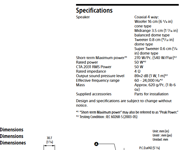

I'd guess that the speakers don't match the unit. See what ohms, watts, etc., it's supposed to run with.

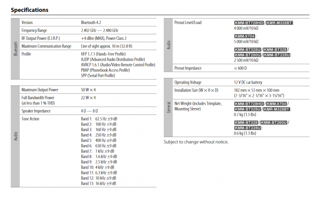

Here are the specs for the speaker and the head unit, respectively. Looking it up, the stock speakers are 25W, 4Ohm. The stock tweeters (which I still have) I can't find any info about in regards to their draw. I think the head unit and speakers are compatible? But I have a hard time comparing the data between these two.
Have you tried turning down the bass, or do they just sound all distorted and blown?
