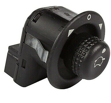

So would this also affect my driver's and passenger side electric mirrors ? Because now my mirrors won't adjust electronically. These are all of my questions so far thank you for your time you have been a major help and a major time savor.

There is a "connector" that is part of the main Mirror wiring harness to the main harness for all the windows on the Drivers Side door - it ties all together into the main one that exits into the car thru a weather-resistant boot - both the switches for Windows, and the Right and Left Mirror control and that little speaker and the big one below in the door by the kick panel.
The Mirror control is
CA6Z-17B676-A
Looks like this...
note - there are two spring tabs - So you can pry it out of the door panel as needed to look for and to get at the connector - you might just want to pull the door panel off completely so you can obtain access to all the wiring.
A better way to go is to remove that whole door panel - the handle that you pull on - has a press to fit trim cover and a simple prying off reveals screws that mount to the panel frame - it's a good start to work with those and you'll also see how the window switch assembly is also "spring tabbed" in place.
There are also two screws that mount from the BOTTOM side panel on the part of the door that swings out - on the door frame that contains screws holding the panel in place towards the latch.
You'll need to do this trim removal anyways to inspect or expect - any sort or repair advice on what needs to be done next.
