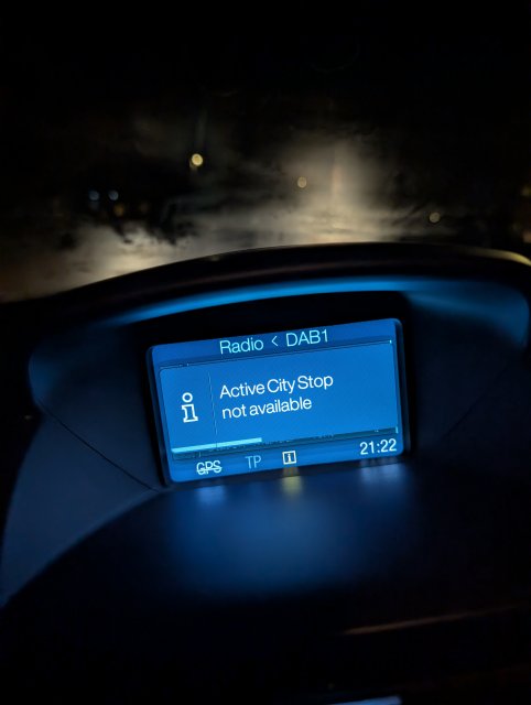

I have a Ford fiesta titanium x 2016 and Everytime I turn on the car this message pops up. Sadly I have looked it up but not found too much information about it. I have already checked the battery which is perfectly fine.
Any advice would be greatly appreciated. Thanks!

Also notice the GPS system is not working - GPS
So "Active City Stop"...
In the UK, Ford's Active City Stop is a driver-assist technology designed to help prevent or mitigate low-speed collisions in slow-moving traffic by automatically applying the brakes when it detects a potential collision.
Tells me one, if not several, sensors in the bumpers are not working so the system shuts down, or it otherwise has a fault so it is not enabled.

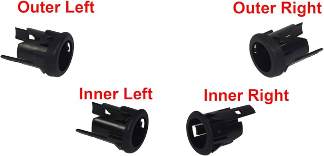

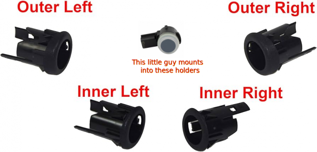

They can look like this...
...OR...
Look like this...
Mount in holes and are clipped onto the holder
