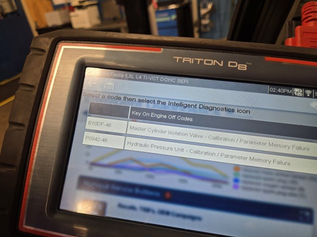

Please help! My abs unit was not allowing fluid to the right front wheel. Replaced the abs unit from a donor and there were several codes. So I removed the module (computer) from my old abs unit and put it in the replacement abs unit. And now I have 2 codes that won't clear. I've tried all the learn and reset procedures in the scan tool. No go. The car will not turn on traction control and the hill assist does not work anymore. My car is a 14 fiesta built 5/2023 with 1.6 non turbo. I replaced it with one from a car of the same month, year and model. Any ideas?

The codes will only clear when FORD uses their scan tool (J2534 and their software) to force the ABS unit in a diagnostic mode to clear the codes stored previously.
The codes will clear (asterisked in FORscan) but will always remain in the system because of the previous vehicle that caused this - and it's VIN code - will always be "reserved" in your vehicle. For it's VIN ID does not match the vehicle so it may also be unable to clear because the previous vehicle may have come from a different TRIM line - SE versus S or Platinum (SES) which their systems handle ABS and it's communication differently.
