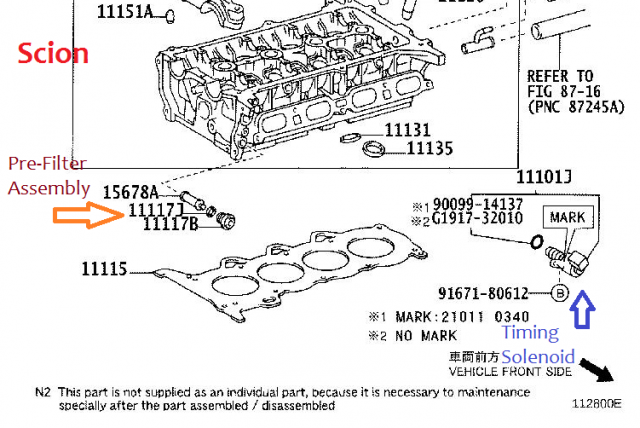

One question though - in the Scion version, they use a screen filter - a lot like that of an Transmission Oil screen pre-filter to keep the oil channels around that solenoid clean. They only used one solenoid and since this was a simpler design of advance and retard, (2004 version year) only one solenoid was used to divide the cams as advance or retard their timing - but at one time simultaneously.
I used to have to take a Torx bit #40 to remove a spring and this pre-filter about every 100,000 miles - and was done during an oil change you can see this filter kept out dirt and metal bits from entering into this system and the Service manual even alerted you to the possibly of premature failure caused by lack of maintenance of this pre-filter.
Does Ford also provide any pre-filter or a method to purge the system to "flush out" dirt that may have reached further up into the piping as well as the chambers? Why, it is my fear - some of this simply cannot be avoided because of coking that oil can exhibit due to the age of the motor and the conditions it will be used in that dirt or coke can flake off the channel path and flow into other areas before it falls into the Engine Oil catch drain-pan..
How is this done on a Duratech motor, is there a pre-filter or screen that can be removed and cleaned to keep the system from plugging or otherwise a premature failure caused by dirty oil? OR is there a procedure someone would like to share in which to purge and remove debris that may have collected during the service life of the motor?
Inquiring minds would like to know!
I'm unaware of any screen or pre-filter on the Fiesta engine. I would think that something like that would be as much problem as a preventative area. It's just better to use high quality oil and filters. My 2000 Ford ZX2 has an early version of VCT . Routine service has been an effective way to prevent issues.
