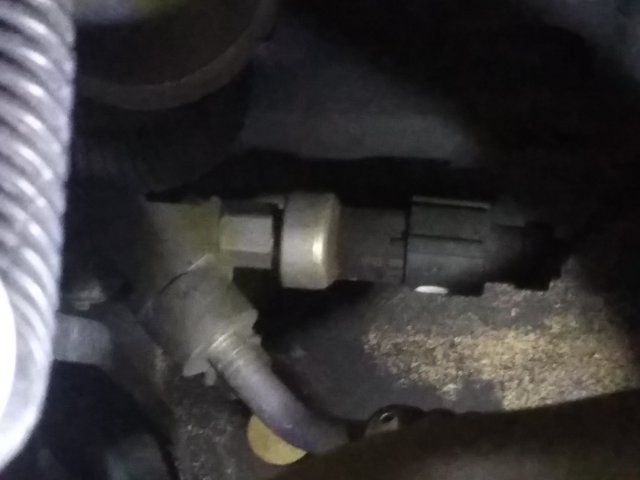

So, you are saying that the A/C is not working at all,beyond the momentary keyon cycle? If that's the case, you either have a low level of R134a refrigerant or the pressure switch has failed.
The pressure switch is under the accumulator tank on the lower right side of the condenser. You can see it if you shine a flashlight below the alternator. IMG_20200713_095228.jpg
You cannot just unthread it and screw in another switch. The system is always under very high pressure at this point and it must be evacuated with special equipment and then serviced. This is a job for professional repair shops with the right equipment.
The pressure switch is under the accumulator tank on the lower right side of the condenser. You can see it if you shine a flashlight below the alternator. View attachment 4002
Thanks for the info. System is charged. Pretty sure it's the pressure sensor. Would you happen to have a part number? I looked on Rock Auto, but couldn't find it on there.
