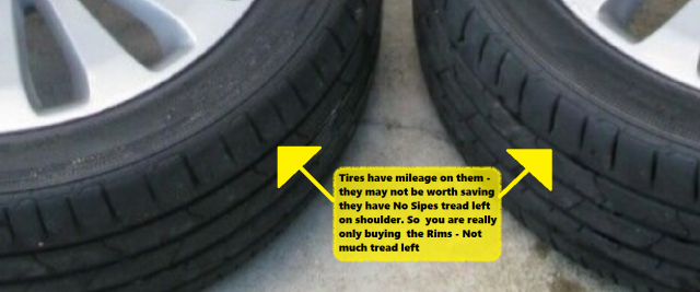

Because, by photographic evidence you supplied - these tires are near their end of useful life - you will have to replace the tires...
Tires? Not so much. These have not much life left on them. They hardly have any Sipe groove left on the shoulder portion of the tire. The Sipes play an important role of traction control and surface contact.
They are there for different performance reasons - mainly of removing and displacing water when you drive - note that the inner tread has lines - but little ability to shove or displace water off to the side. Those side channels help move water from the inner channels. Look closely, those sipes on your tires shoulder sides are not there - they're blocked from draining off water from the inner channels. Sadly - these types of (worn) treads "dam up water" ahead of them as they roll, and force the water to channel thru inner grooves but cannot shove water off the road surface tread contact. These tires will do fine for a light rain at lower speeds - but high speeds and any rain light or heavy - these tires won't do well. And if there is a lot of water to displace from rain or winter melt, as the speed increases - that dam forms a larger and larger wake and the tread itself can float upon that wake of water and lose more and more of tread surface to this water displacement losing friction and hydroplaning is possible making it harder to keep your car on the road.
Their useful life is about gone - I would not use them for winter or monsoon seasons.
