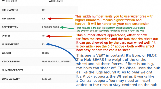

To help,
My Fiesta came stock with 16" rims and they were 16 X 6.5 X 4 (108mm) and are alloy - they have a 47mm Positive offset - or Rim center-line to Hub Center-line are nearly spot on in balance - Smaller numbers will affect the balance the wheel will feel in your hands as well as how hard or how much effort it will take - to turn those wheels.
I have several posts 'bout those tires Ford chose to put on there. There were Toyo Optimo and must have had a 40,000 mile warranty. They barely lasted that duration. And they suffered being under the car in Michigan roads in winter and summer conditions - being 195 - 50 R16 with a +47mm Offset (Tucked in direction) - This was Ford's choice. I learned a lot remembering that...
Got better tires using 185
60 R16 on those OEM rims and even went out shopping and bought 15"
steel - stock rims of that 15 x 6" x 4 (108) and use now 185 x
65 R15 and kept the 47mm Positive offset for balance and operation to help in winter. I then swap out the winter for summer tires using the OEM 16" rims I got with the car. I went with 60 and 65 percentage numbers on a Narrower tire to reduce the torque steering I got from the wider tires (195 width) on rough and rutted bumpy roads - which helps in controlling your vehicle from becoming a mess in a skidding condition - as well as kept similar height and perimeter (How far it travels per number of turns) so it doesn't affect the odometer and speedometer readings.
However - as a bit of advice, keep a spare set of rims and wheels / tires combo so you can keep going. You never know what will be laying on the road in your way - around the next bend.
Because? It's in the Physics - the wider tire caused several issues with steering - suspension and even Axles. Sadly - I am still working with the car to iron out many little things that dealerships have done to the car. Tire scrub, higher profile, being wider also affected traction, rolling resistance and subsequent fuel economy. This just their contribution - so friction, traction, stiffness and handling are affected by tires in size, and by their performance which will take it out on you and the car.
So in my opinion, please - do your research, you cannot leave the fate of your vehicle to others whom may not share your values morals or ethics on driving let alone the care and maintenance of your vehicle - without knowing what is at stake with any vehicle - let alone one that's no longer in production - so parts to fix it are scarce and even scarcer are the people that know how to fix these things.
